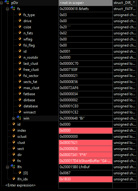

Hi, I am a bit stumped at the moment. I attached the files that use the main code.
In usbh_usr.c, the function 'USBH_USR_ReadWriteFirmware(void)' is the ffucntion that attempts to open the file.
The line 'if(f_open(&file, '0:g4_firmware.bin',FA_READ) == FR_OK)' is not returning true even though I have a bin file with that name.
f_open is in ff.c
It looks good to me? Does anyone see something wrong?
I am using Keil 5.18, and an STM32F2.
Thanks for you help,
Daniel

Posted on May 17, 2018 at 19:18
But what error specifically is it returning?
Are long file names supported?
Is this an EXFAT volume?
Is the volume mounted?

Good question.
When entering f_open, this is the order of events.
After chk_mounted, res = 0.
After follow_path, res = 0x4 --> FR_NO_FILE
But I have a file there.
I believe this is FAT32.

Posted on May 17, 2018 at 19:49
It returns that value from the function static FRESULT dir_next(DIR *pDir, BOOL bStreach)
At this point:
wi = pDir->index + 1;
if((wi == 0) || (pDir->sect == 0)){
//Report EOT when index has reached 65535
return FR_NO_FILE; //Hitting here
This is pDire when I hit the
FR_NO_FILE in the code shown above.
Posted on May 17, 2018 at 19:56
Probably should review setting in ffconf.h, these would be controlling.
Would expect the FatFs code to be fine, issues going to be with other code and settings.
