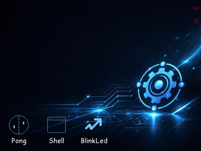

A Graphics Engine
  • Hardware-accelerated 2D rendering pipeline using the LTDC and ChromART (DMA2D) accelerators
  • Drawing primitives (rectangles, circles, lines, arcs), BMP 24/32-bit image rendering
  • Full Unicode text rendering (UTF-8/16/32)
  • UI widget library: buttons, text fields, edit fields, graphs, cursors, layers
A Shell Built-in interactive shell with support for both native and dynamically loaded commands.

Application prototype: A minimal application example can be found here (a simple BlinkLed). It must be paired with a linker script, an application descriptor (mk_application_data) and compiled with the following flags: -fPIC -shared. Symbol resolution at runtime is handled in mk_application_loadDynamic() and in this sources directory. Other example applications can be found here: a Pong game and the built-in Shell.
Graphics Engine: The graphics engine is composed of several tasks that execute painting callbacks, input-listening callbacks, and process drawing requests submitted by applications. Each module is isolated and interactions between components go through asynchronous requests. The rendering pipeline entry point is mk_display_painter(), the listening entry point is mk_display_listener() and the request manager entry point is mk_display_handler().
