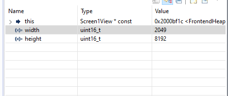

The Question :
As i can see from the debug f_open Finds the file and stores it to f variable. I can also see the data in f in the touchGFX task , So i think this part works.
But the function
 BMPFileLoader::getBMP24Dimensions(&MyFile, width, height);
returns Huge width and height
and
bmpId = Bitmap::dynamicBitmapCreate(width, height, Bitmap::RGB565);
returns Invalid ID

Does Bitmap::dynamicBitmapCreate(width, height, Bitmap::RGB565); always return invalid ID? Also, are you aware that the simple BMP file-loader in the article is for 24-bpp only?
Try with a small example just to ensure that you can allocate space in the bitmap cache.
dynamicBitmapCreate() returns BITMAP_INVALID if
  • You're out of space in the cache
  • If caching failed even if you have space for an image (not supposed to happen).
/Martin

Dear Martin,
Just found it,
i replaced the :
  1. BMPFileLoader.cpp
  2. BMPFileLoader.hpp
files that i copied from this link https://support.touchgfx.com/docs/development/ui-development/scenarios/loading-images-at-runtime/
with some files i found in an example in the forum, and it Works fine.

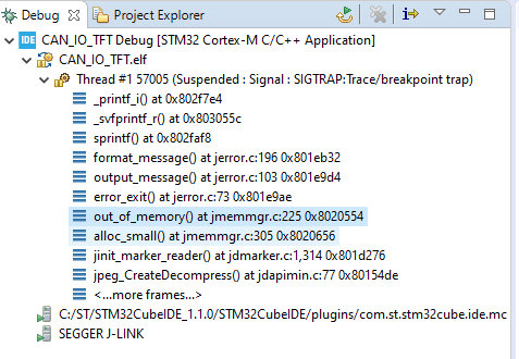

 Now i am trying to do the same thing with Jpeg files,
Is there any example using Jpeg , or JPEGLib Source that i can use ??

So you're saying there's an error in the code in the article? I'll have to follow up on that.
Check this forum if you can, i uploaded an example using a JPEGFileLoader at some point (uses libjpeg).
/Martin

Or i am using an other version of some tool (touchGFX etc).
I think i found the example you are talking about, i ported the libjpeg and the common files but the code gets stuck in
 JPEGFileLoader::getJPEGDimensions(f, width, height);
I am using the same cash configuration as in bitmap.
Is there some other cash/memory configuration i have to make ?

The example i uploaded was only tested on windows / simulator. Pretty sure our demos from the designer use dynamic images (jpegs) - i don't have time to check myself right now
