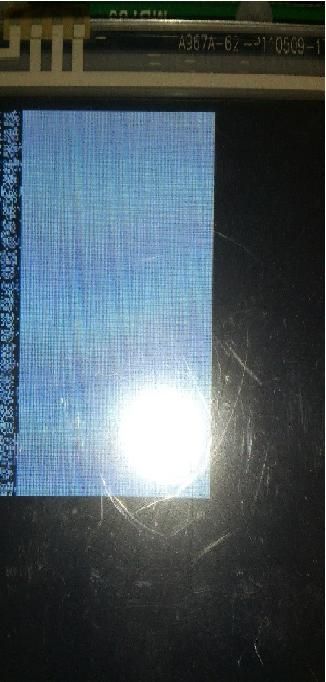

Hi everybody. I'm trying to display a bmp on 3,2'' TFT by using FSMC and stm32f4 graphic drivers. I've done writing some texts changing backcolour drawing pixels but when I want to draw or drive a bmp file with LCD_DrawMonoBMP or LCD_DrawColorBMP functions LCD shows me just white with some noisy white image. I added the screenshot. I need some help. Thanks a lot..0690X00000602lYQAQ.jpg

    You might need to provide some more detailed information about your issue.
    From the vague description, I guess it could be a scale/orientation problem, or an uninitialized GRAM. My suggestion is to erase the the screen and draw some primitives (lines, pixels) to check that. The next step would be some small high-contrast test images.

    Thank you fm. I can draw primvites. But when I want a draw/send a bmp file to the LCD, program is branching to the HardFaultHandler and display shows just white pixels.

    I'm using LcdHal.c driver functions and I'm callin LCD_DrawColorBMP(''untitiled'', 239, 319, 240, 320); ,bmp file is in the same file with the main.c
     I try to write just ''untitiled.bmp'' but it's still branching HardFault_Handler but there's nothing on LCD.

    Well, looks like you are half-way there.
    I don't have any hardware that uses FSMC to drive a TFT, so you can't expect me to reproduce the issue. And, I do not use the graphics library.
    But if you end up in the HardFault handler, I suspect an access to a nonexisting GRAM address. I would either try to single-step through the offending function (possibly in assembly mode), or set a breakpoint in the HardFault handler and decode the associated registers for the reasons.
    There are nice hardfault handler examples originally written by Joseph Yiu, which could be of help for you. You can even look inside this forum (if it got not lost during the last forum software updates...).
    I would expect the reason to be some incorrect initialization or adaption of the library code to your hardware, like some colour depth mismatch. But as I said, I neither have the source code, nor the hardware or schematics - I can just guess.

    If font and pixels are working i suggest that you try a other type of bmp file or find first out what bmp is supported by your code.
    There are different type of bmp files, for example with or without rle encoding, etc.

    I've tried 16-bit bmp, 24-bit bmp and 16bit(565) coverted with ST's Resource Editor For Embeded GUI Library it is still same.. Now I'm trying to find reason of the HardFault_Handler (Joseph Yiu's Definitive Guide). I get an error then write the codes. I'm using Keill ;
