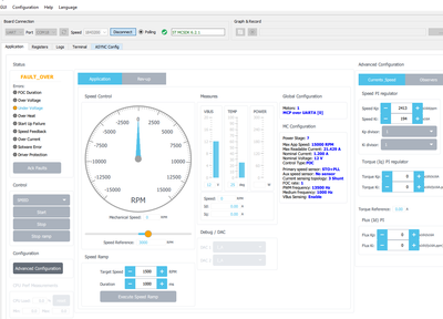

Hi, I am new to ST evaluation board. I am trying to connect STEVAL-SPIN3204 board to a windows 10, and it is not working.
In more details: The board is working with stsw-link007 (ST-LinkUpgrade) and loads the recent driver version (V2J43M28). The USB connects to Windows as Drive D with details.txt file.
I loaded en.stsw-link009 drivers (64 bits) and updated the com port (STMicroelectronics STLink Virtual COM Port (COM3)) driver to version 2.2.0.0 dated 4/1/2021. The COM port hardware Ids are USB\VID_0483PID_374B&REV_000&MI_02 and USB\VID_0483PID_374B&MI_02.
The COM port is configured for 115200 baud, 8 bits, not parity, 1 stop bit.
However, when it is connected to the ST Motor Pilot V.1.2.5 that came with Motor Pilot 6.2.1 - it is not working and the board remains disconnected. Discover Board fails with the following message:

[ERROR] - : Failed to discover Board at 1843200 Bauds and 115200 Bauds
[INFO] - : disconnect UART START
[INFO] - : Disconnected from board
[INFO] - : disconnect UART END
and terminal shows Tx msg of 85FFFFF (ASPEP_BEACON) and no Rx msg (ERROR:ASPEP BEACON TIMEOUT 500ms).
I replaced the cable, and used another (similar) evaluation board - and the issue remains.
What am I missing here?
Thanks for any idea that will solve this issue.

Hi, Finally it worked. Sort of. Had to reset and use the user button on the inverter in order to successfully finish the profile. Start with the app button caused all sorts of errors and did not finish.
Thanks, a little progress...
 Please can anybody helps me why I'm getting under voltage notification and I'm using in the power supply 12 volts, so I need to ignore this notification and it just run once and after that I need to repeat the same step everytime, please if anybody can give me feedback or how to solve this issue.
I'm using the SPIN3201.
