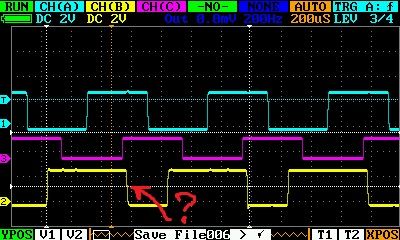

I've been trying to make a motor controller out of STM32VL-Discovery (STM32F100RB). However I wanted just to check the waveforms and decided I could do without additional hardware. I'm emulating Hall signal with TIM2+DMA+GPIO. And emulation works great untill I try to initialize TIM3 or TIM4 as an interface timer. When I call TIM_Init() function, Hall emulation forms get corrupted. This happens immediately after entering the function, no actions done. And the optimization level setting of the compiler makes difference for how exactly the form is corrupted. It looks like something is messing with DMA preventing it from setting GPIO bits properly.
I run CooCox IDE 1.4.2 with arm-none-eabi-gcc-4_6. Here's the code and illustrations:

All the way until here everything is great. User LEDs are not powered and the waveform looks exactly as I need it: 0690X00000602sFQAQ.jpg Then something strange happen:

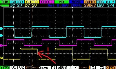

After this PC9 LED comes to life (constant high level) and the waveforme changes as follows: 0690X00000602xEQAQ.jpg Yellow line is PC I've tried to change interface timer to TIM3/4 - no matter. Changing optimization level changes more than one waveforms. Initing OC/IC changes more than one waveform. This is a complete mistery to me - please please please help me out. Thanks in advance #hall-sensors #dma #stm32f10x

Just in case someone stumbles upon same issue. The problem was in multiple peripherial initialization - in STM32 i guess you should start clocking each peripherials only once.
