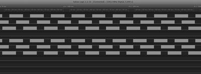

I try to implemend sinus algorithm for BLDC engine on  STM32G474RE chip.
I want to use TIM1 (CH1 - CH3) and (CH1N - CH3N) to control a bldc controller. I have configured a complementary output with dead time according to datasheat (so I think) and I have a phase shift problem. Output waveform:

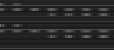

At first glance, everything looks good, but after zooming in:
 The 3rd(CH3) signals and 6th(CH3N) are shifted by ~2ms. Does anyone knows what could cause that?
