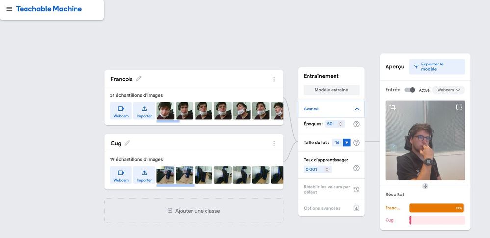

In first time, I create a model with these parameters :After, I select Tensorflow Lite, check Quantized and export my model.
I try different parameters.

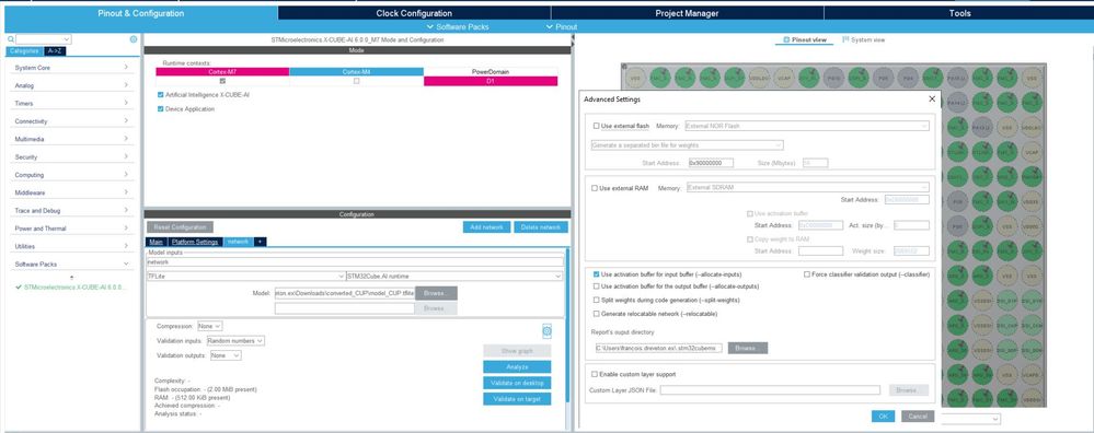

After, I want to add my model in CubeMX (like https://www.youtube.com/watch?v=NDshmSH7WnA&list=PLnMKNibPkDnG9IC5Nl9vJg1CKMAO1kODW&t=1s).

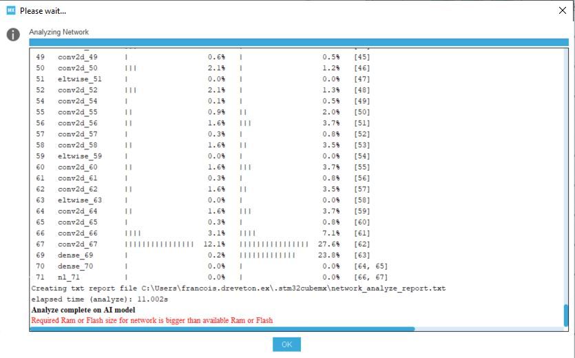

I select these parameters (X-Cube-AI version 6.0.0) :Then, I analyze my model. The analysis returns an error. The model is too big :
