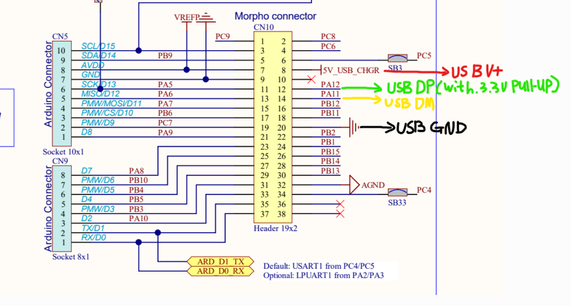

I intend to update the firmware using STM32CubeProgrammer with the following hardware configuration
Additionally, I have set the Boot0 pin to High using a jumper.

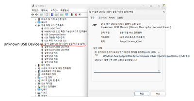

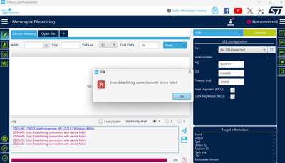

However, my PC is not detecting DFU mode.
Additionally, the programmer is not recognizing the USB connection.
Did I miss anything?

You've missed the fact that the pullup is already present in STM32G. No need for an external one. ;)

The same problem occurs even in situations without pull-ups.

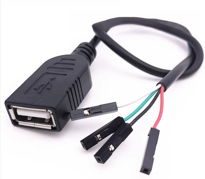

The current connection interface uses a cable similar to the one in the attached photo.
