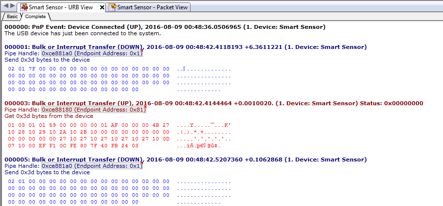

usbh hid custom device issues
jhgorse
Posted on August 09, 2016 at 06:36
I am trying to get a custom HID device to work on my STM32F429ZI board using the USB Host driver from the latest CubeMX for F4. I have successfully received boot mode keyboard data with this driver. The intended device requires report mode as far as I can tell. The device enumerates fine and with a few modifications we make it through to the usbh_hid.cUSBH_HID_Process() state machine. As described
http://www.keil.com/forum/22428/stm32f4-usb-host-hid-application/
by Tsuneo Chinzei, I've added some states so that we can send data over the interrupt out EP then receive data from the interrupt in EP.

Sending appears to always work, though the buffer never changes in the receive interrupt and it always says the URB status is IDLE. For reference, this is a working example of what I want written in a handful of lines in ruby using the HID API library:

How can I get this simple HID use case to work with the CubeMX USB Host driver? Cheers, Joe #hid #!cubemx #usbh

My issue was with the DATA0/DATA1 toggle. It needed to toggle in order to continue operation past the first OUT/IN sequence over the Interrupt Ep 1. This is solved now.
Cheers,
Joe
P.S. The TotalPhase Beagle 12 made all the difference in the world for learning the USB spec by actually watching working devices and exploring that way rather than the endless texts written about it.
P.P.S. Microsoft Sharepoint was not meant to do this. Please use something with better performance at scale, like the Usenet Newsgroups, PHPBB, dialup bulletin boards, and so on.

Use Wireshark or Beagle to snoop the transmission and decode the packets. This will show you if you are toggling DATA0/DATA1 or not. Good luck.
