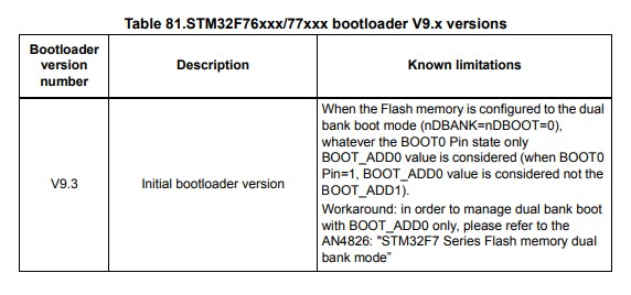

Yuri Andrade Rodrigues
Posted on February 16, 2018 at 06:02
About the question 2, It was working with nDBANK = 1 and nDBOOT = 0. It is an invalid combination but it worked nDBANK
=nDBOOT
0. Something is wrong....
As Tonny has answered in this topic:
https://community.st.com/0D50X00009XkduQSAR
That note breaks the bootloader flow and it doesn't let me use the F7 as I use F4.
I was thinking to use BOOT_ADD0 pointing to my bootloaderand BOOT_ADD1 to the embedded bootloader, and then, I could use BOOT0 pinthe same way that F4 uses.
Doug, as you answered in question 3, in your case you modified BOOT_ADD0, right? Or you got both working with dual bank?
Thanks
Yuri Rodrigues
