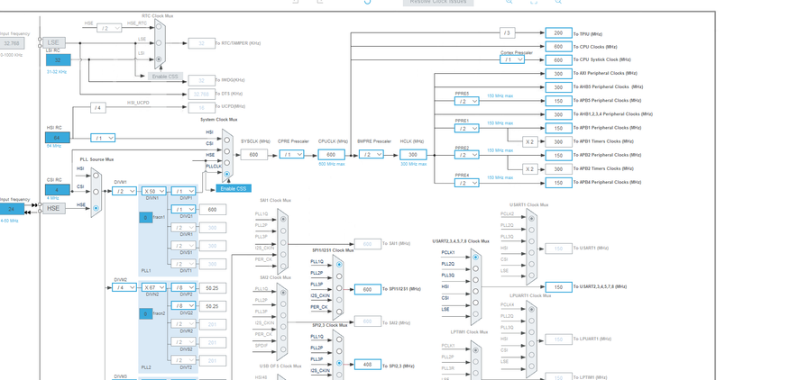

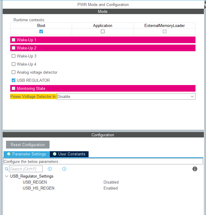

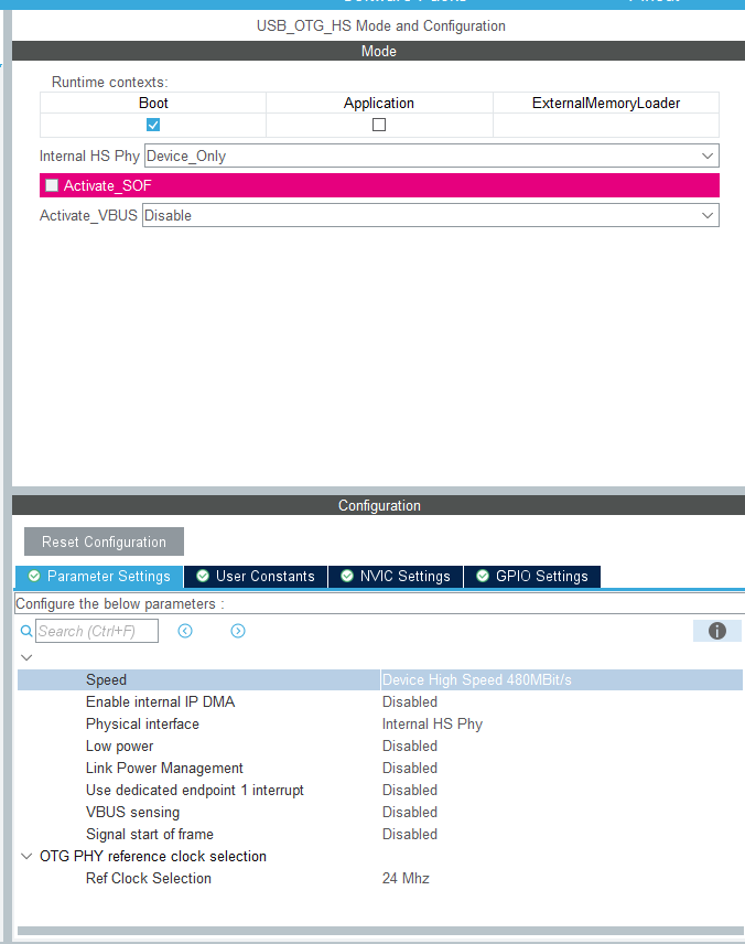

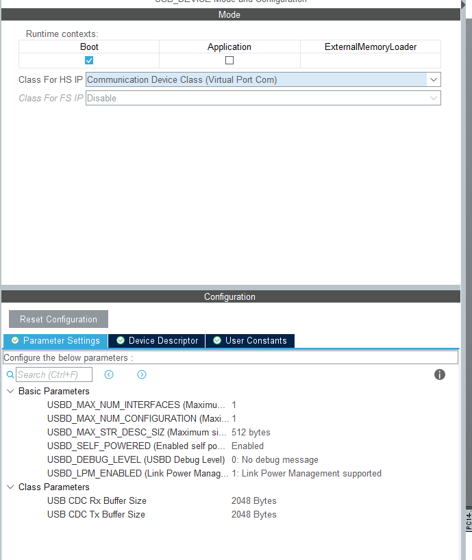

Here is my STM32 configuration:
Clock :
USB Clock :
Power Regulator :
USB HS Configuration :
USB_DEVICE Configuration :
Here is my configuration.

The behavior you see (code stuck in USB_CoreReset() waiting for USB_OTG_GRSTCTL_CSRST  to clear) is a typical symptom that the USB core is not correctly initialized, often due to a hardware or clock configuration issue. Check this FAQ: Troubleshooting a USB core soft reset stuck. I'd suggest checking your configuration including clock source and PLL settings, clock...
