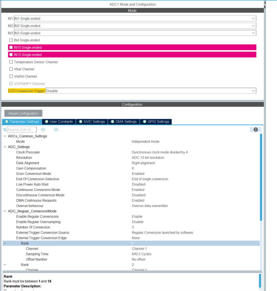

CGonz.5
Dear Heol,
I tried to confgure all that 3 analog inputs like this:

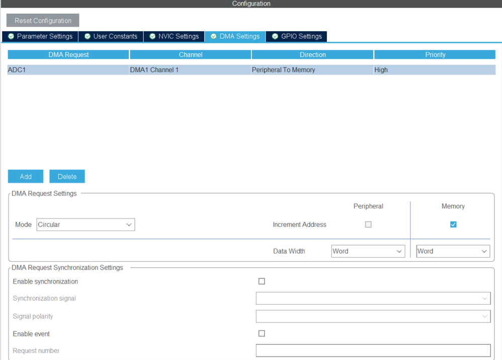

I started a new project without FreeRTOS, and this configuration works fine. I have my 3 channels stored continously in a 3 position, 32-bit array.
When I use exactly the same configuration but using my USBPD application and freeRTOS, DMA is corrupted: USBPD is nos responding and DMA is not storing anything in my array (I am reading that array by UART).
It seems that something is happening when using another DMA channel added to USBPD application.

Dear Heol, Tania,
Issue was solved some time ago by using ADC1 channels 1, 2 and 3 with continous reading by DMA to map all my 3 parameters. I passed ADC1 channel1 reading to my PD application and channels 2 and 3 to read other magnitudes.
ADC2 was unusable at the same time thatn ADC1 if I want FreeRTOS PD application running properly, so there must be an incompatibility issue there.
