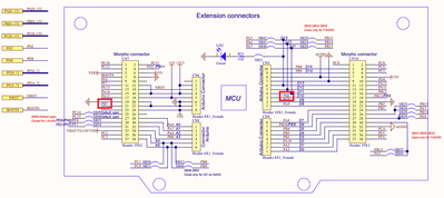

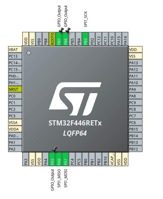

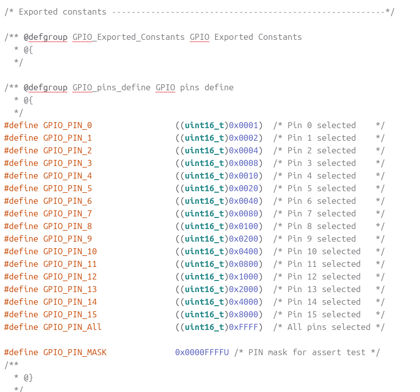

rather simple issue I have, I am trying to figure out the connection between the actual port naming on my board and the GPIOs defined within Drivers/STM32F4xx_HAL_Driver/Inc/stm32f4xx_hal_gpio.h for example.
I cant find the reference, where are PB7 or PB6  on my board if I want to connect these to some other module through  wiring:(

The Board's schematic or the reference manual of the board are the right places to look at:
PB6 is located at CN5 (Arduino connector)/pin 3
PB7 is located at CN7 (Morpho connector) / pin 21:

this is beautiful, thank you !
