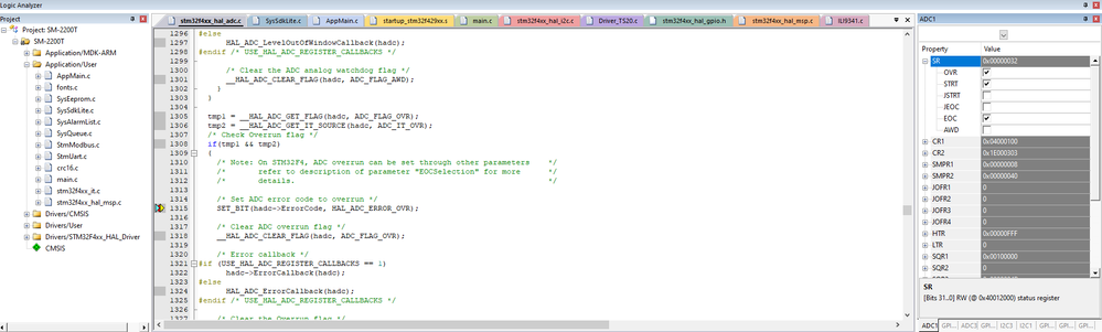

every conversion set ADC->SR OVR bit.

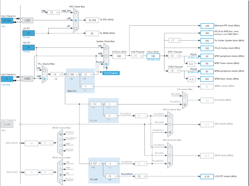

I guess overrun is probably caused by clock speed or timing. So I added a timer so that the ADC trigger at 0.5 Hz period, but the result is the same. I need help.

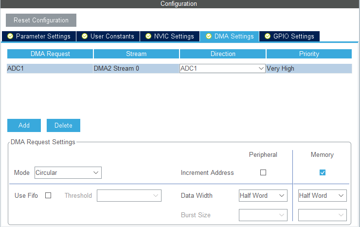

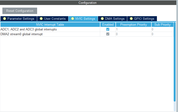

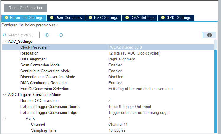

HJung.6
add mxcube setting.
