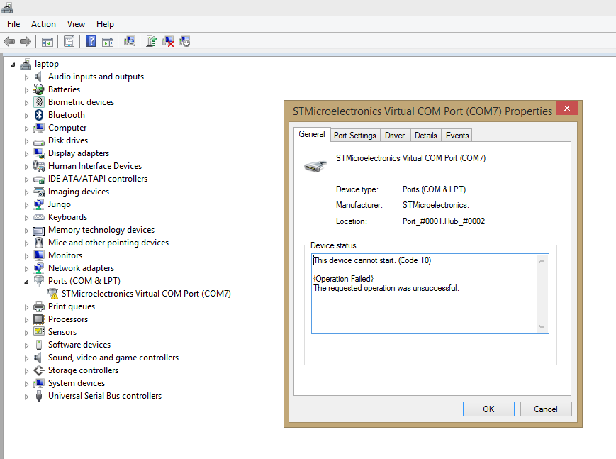

I'm using this example
STM32Cube_FW_F0_V1.7.0\Projects\STM32072B_EVAL\Applications\USB_Device\CDC_Standalone
Which should simply present a VCP in Windows/Linux, after the drivers are installed (for Windows):
http://www.st.com/en/development-tools/stsw-stm32102.html
For the setup, I do the following
- ''For power supply from USB (CN4) to STM32072B-EVAL only, JP19 is set..'' - from
http://www.st.com/content/ccc/resource/technical/document/user_manual/63/18/cb/de/57/a6/45/17/DM00104135.pdf/files/DM00104135.pdf/jcr:content/translations/en.DM00104135.pdf
- link TX / RX for loop-back using jumpers (but not important I just want the device to be recognised for now)
- connect a standard USB cable from CN4 USB port to my computer. The cable is fine, as I also use this one connected to CN13 for programming via ST-Link.
I checked to see if what recognised by Ubuntu / Linux. It is not
Am I missing something?

Posted on February 01, 2017 at 17:33
Hey Chendy. Ok, downloaded a fresh copy of the same source code -> imported the CDC_EXAMPLE project -> compiled and tested on our same target board (STM32F072-EVAL). Also initially noted the yellow bang (screens are attached) and reviewed the following important steps:
1) be sure that the USB cable for the ST/LINK is connected - this powers the kit
2) then dock the cable for the USB interface to perform the CDC emulation. Also right-click the current yellow bang mark and select UNINSTALL AND check the box to delete the driver. This will force a fresh start for your device driver links.
3) Install the VCP driver using the installer package supplied with the 1.4.0 VCP driver package (yours appears to be the same but included in our download as well).
4) A compiled HEX file is also posted in this download for your testing.
Curious to hear about your results.
BTW - Any chance you a virus protection s/w running in the background that may be halting this installation ?? Known to happen and be sure you have admin rights.
https://axxonshare.s3.amazonaws.com/STM32F072-EVAL/STM32F072-EVAL_CDC_EXAMPLE.zip
Update:
1) We are on Win7 x64 - have not yet tested on Windows 8.x nor 10. According to the readme - should work fine on Windows 8.x
2) Tested with the power jumper for CN4 - works fine using a single cable to power the eval kit.

Hel
lo,
Maybe the problem is due to heap and stack memory sizes defined in startup file.
Try to increase the heap and stack size and p
lease keep me updated on the progress.
Regards
Imen
Thanks
Imen
Jennifer D
Posted on January 30, 2017 at 22:34
Back again.
Imen D is right. For those in IAR the heap and stack sizes are sorta hidden.
Project ->Options ->Linker and then edit the linker configuration.
Change 200->2000
400->4000
This worked for me! I am so excited I have been working on this for over a week.

Posted on January 31, 2017 at 13:16
So no luck for me...
I have increased the stack size 400 to 2500 (the max before non-compile), heap 200 to 2000. I cant increase the stack to 4000 (as per Jennifer D's tip) - it doesn't compile after this 2500.
Im using the free STM32 provide Keil offer. Could this somehow play a part? Is there a chance it is compilation size limited?
With these settings still same: not recognised.
Also the 4 leds (ld1, ld2, ld3, ld4) are all flashing about about 2hz (incase that helps debug)

In my case (simple USB CDC project I made myself on a Nucleo-64 board), Linux would not enumerate the device.
The solution was the trick on p. 7 of the PDF referenced by Jennifer : edit usbd_conf.c and change
hpcd_USB_OTG_FS.Init.vbus_sensing_enable = ENABLE;
to :
hpcd_USB_OTG_FS.Init.vbus_sensing_enable = DISABLE;
Yet, I did disable VBUS sensing in CubeMX. Is it a bug in the code generation ?
