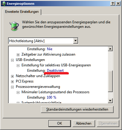

I use the current version 1.5.0 of the STM32 Virtual COM Port Driver.
Sometimes i got a bluescreen during my running Win32 App.
As far I know, this problem is related to usbser.sys. But how to fix it?
I'm using Win7 x64 and the usbser.sys is version 6.1.7601.18247.
I do not expect any help from microsoft.
But can STM force a bugfix or: Develop an own CDC driver for Windows?

‎2019-10-07 11:50 PM
There is an option to disallow the OS from putting the USB device to sleep. Disabling this option has resolved some blue screen issues for me. It's not clear if it was an OS issue, a driver issue, or a hardware issue. Google USB Selective Suspend. Might be worth a shot.
‎2019-10-08 1:24 AM
Hi TDK,
I think, we can exclude this. I have done this as first after installing the OS: Disable all Energy save options and put all other options to 100% performance. One part of this is also to disable selective USB suspend.
Knut
