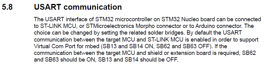

The The STM32 Nucleo boards integrate the ST-LINK/V2.1 interfacing with the PC and offering the following capabilities:
  – Debug and programming port
  – Virtual com port interface
  – Mass storage interface

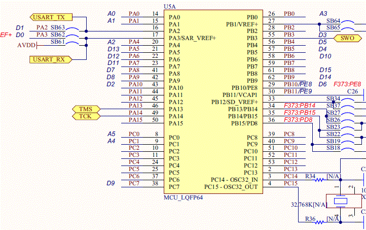

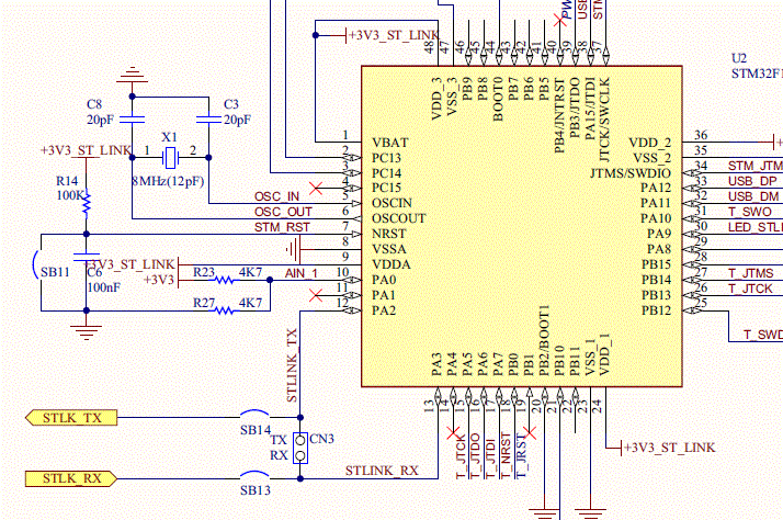

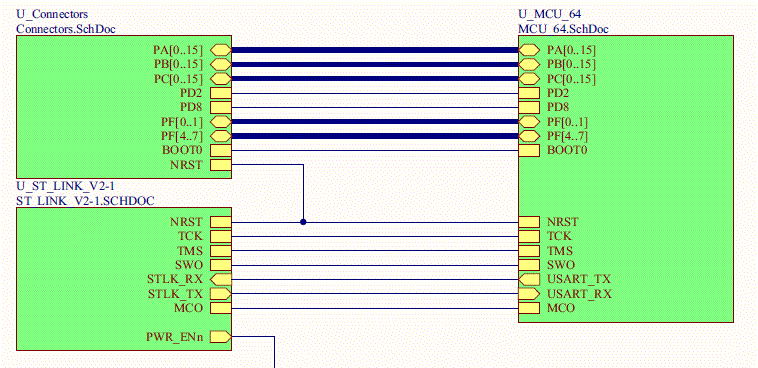

On my nucleo the USART on PA2 and PA3 is connected with the ST link.
Does this mean, I can use USB / virtual COM with this USART pins?
Posted on September 17, 2014 at 17:22
The ST-LINK facilitates it's VCP via the USART pins attached to it.
