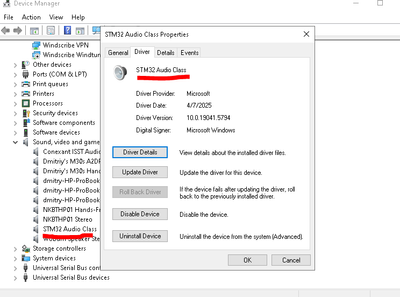

I am trying to get  STM32H743iit as usb_audio_device with CubeMX latest version.
No initialization of stm32 sound device in windows 10 device manager.
Other projects from this link  https://www.waveshare.com/wiki/OpenH743I-C  especially USB_FS, USB_HS working good, but in windows devise manager  no descriptors info in usb device properties windows for HID project. Could somebody help where i am got problem with usb_audio_device? I change VID, heap size but it is do not help.

Hi FBL.
Thank you for reply
Already done for initialization of 2 ch USB_FS, at least we got STM32 Audio class in device manger.
