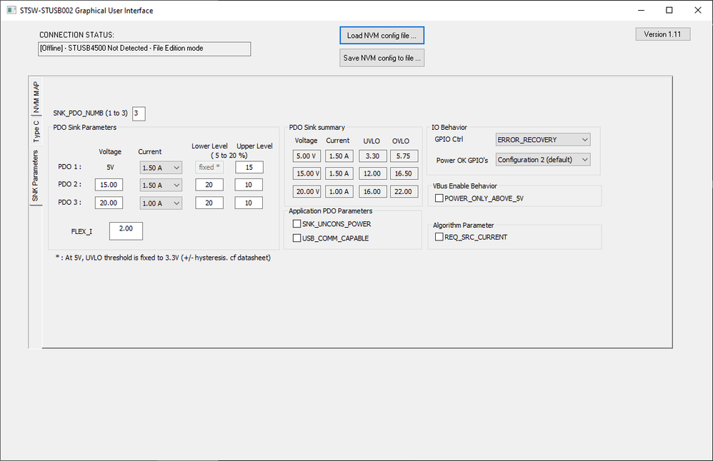

I have the same issue but I am running STSW-STUSB002 v1.1.1. The NVM config for STUSB4500 will not work on the STUSB4500L.

Mmade.11
The documentation on the register mapping, especially for the NVM, is extremely poor. I had to go hunting through the ST code to understand how to program the NVM and then port that to Linux. Do you know of a way to identify the 4500 vs the 4500L part? The device id returns the same value for both parts.
Mmade.11
And to answer your first question, I do get the SINK PARAMETERS page on v1.11.

Mmade.11
We are in the same trouble boat. The ability to get parts is hurting our development as well.
Yes, I do get the "SINK PARAMETERS" page on v1.11. I took a screenshot and it is above.
MIMBE
Thanks. And it doesn't work?
I mean not trying to import a whole NVM config, but entering ALL parameters one by one?
