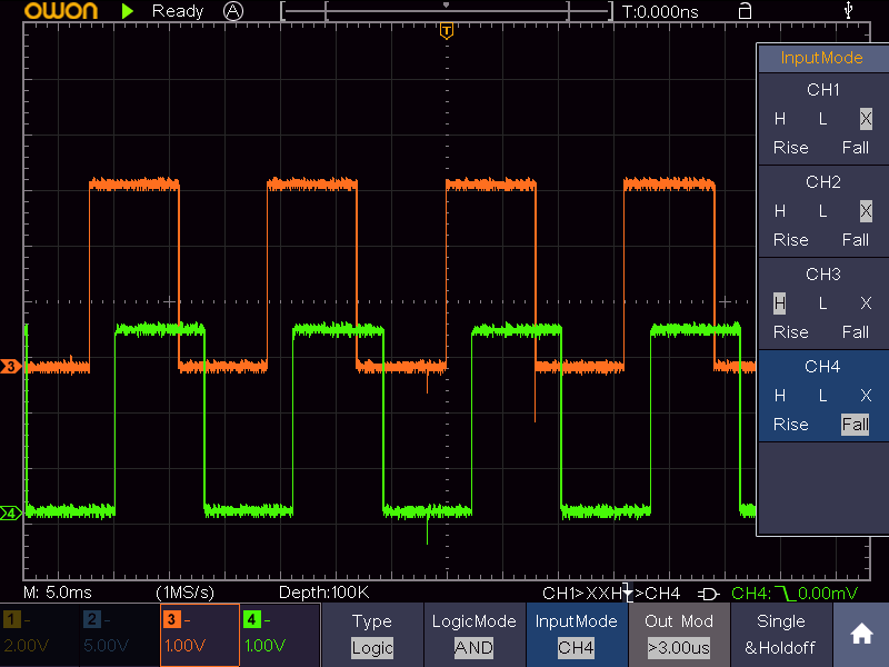

Hello Jan,
thank you for your reply very much.
It took me while since I was reassigned somewhere else - obviously.
I did check it how you advised though. I toggle some pin (ch4) when I finish reading and converting data from the external flash, and togggle another pin (ch3) when I finish transmission of previous chunk of data.
The chunks read from flash and sent through I2S are the same of size:
256, 8-bit read from the flash, converted to 128, 16-bit.
128, 16-bit sent through I2S
As you may see on the screen shot appended, 'normal sittuation' is when:
ch4 rising edge is on high level ch3
and
falling edge of ch4 is on low level ch3.
I was trying to trigger for following events:
ch4 falling edge on high level ch3
ch4 rising edge on low level ch3.
These never happen, so I persume, that conversion of SPI Flash data is always finished before beginning of I2S transmission.
Should I provide some flow diagram or state machine to make it more clear?
Privately I could also share some code I believe.
With kind regards,
Michal
MBank.1
I just figured out another event, that might be alarming.
in HAL_SPI_TxRxCpltCallback I trigger conversion of the buffer from 8-bit to 16-bit buffer.
There I check the state of the buffers. Each run, after reste of MCU I get exactly 3 events, where the state is unexpected.
It should mean that the buffer which was supposed to be updated, was not transmitted yet.

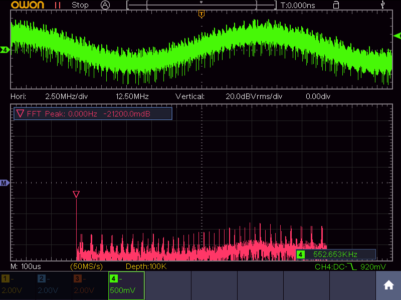

That's 1kHz sine wave that was sent via I2S to UDA1334 DAC, with it's FFT. Looks pretty awful too me, although it sounds pretty much like a 1KHz wave... I think it shouldn't look like that though. It looks pretty much the same with and without load. As load I am using BT speaker, connected via aux cable, powered of internal battery.
I think I will use some spare time to check if values sent via SPI I2S are the same and whether they create a nice clean sine wave at all. What do you think?
waclawek.jan
It's easier to check something simpler, e.g. a sawtooth. It's also easy to generate - simply store an incrementing value to the output buffer.
