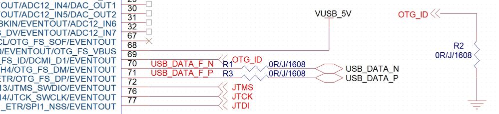

How can STM32H743 use USB3.0 ? If you have source code then let me know.. please reply... have nice day..
