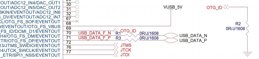

Hi~! I am Korea Audio engineer.I use STM32F207VCT6 Micro controller. Reading USB 2.0 and Micro SD card and transmits data to codec. But it can't read data on USB 3.0 How can I use USB 3.0 format in the STM32? If I use STM32H743x then can usb USB 3.0?
Ipark.1
3 REPLIES 3
Bouraoui Chemli
Hello @Ipark.1​
Would please specify your question ? Do you want to plug the STM32H7 in USB 3.0 port?
STM32 MCUs supports only USB2.0 HS or FS.
If you plug the STM32 to an USB3.0 port the STM32 will work only in USB 2.0 mode.
Best regards
Bouraoui
hi~! Mr Bouraoui...
If I can't use usb 3.0 with STM32 then I will change micom to STM32H7xxx.
STM32H7xxx can read data of USB 3.0 ??​
If you have source code then please let me know..
please reply... Thank you..
