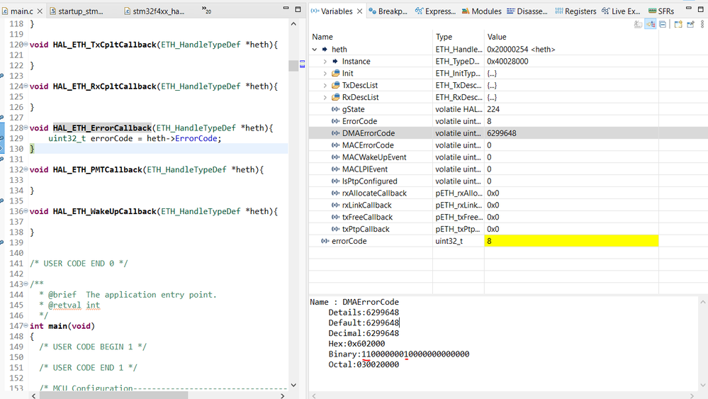

I have an STM32F407 with the ethernet PHY DP83848.
I cannot ping the device if I'm using the LwIP because I'm facing some errors.
I belive that this can be an bug in STM32CubeIDE 1.9.0.
I do the following steps to reproduce the error.
  1. I start up my PCB board
  2. I let the initialization do its job and I get no error back.
  3. I plugin my ethernet cable
  4. I ping a random device with a random number

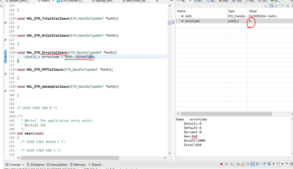

Then my activity LED blink on the DP83848 and then I get an interrupt.
I get the error code 0x8. That means I'm facing DMA issues. But why?

void HAL_ETH_ErrorCallback(ETH_HandleTypeDef *heth){
	uint32_t errorCode = heth->ErrorCode;

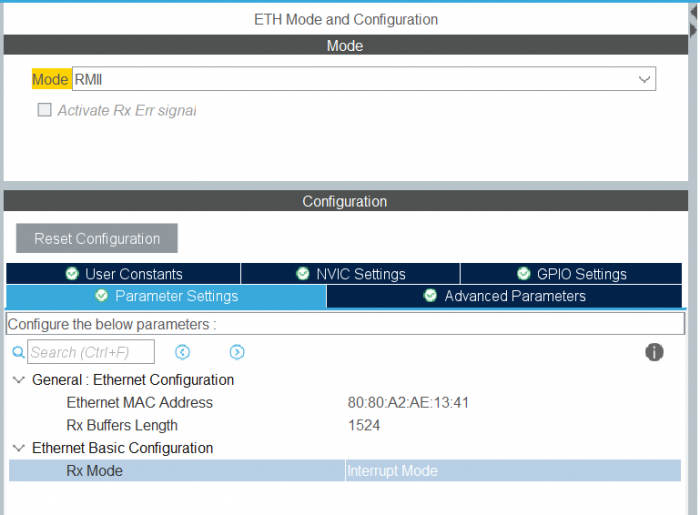

  heth.Init.MediaInterface = HAL_ETH_RMII_MODE;
  heth.Init.TxDesc = DMATxDscrTab;
  heth.Init.RxDesc = DMARxDscrTab;
  heth.Init.RxBuffLen = 1524;

 Update:
Here is more information. I found a DMA error code.
0693W00000LyBzOQAV.pngHere comes the error code from. See arrow.

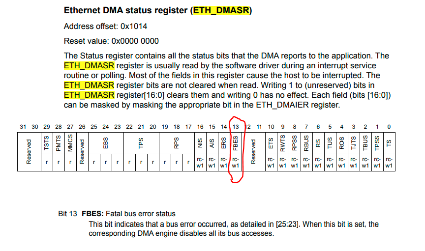

/* ETH DMA Error */
  if (__HAL_ETH_DMA_GET_IT(heth, ETH_DMASR_AIS))
    if (__HAL_ETH_DMA_GET_IT_SOURCE(heth, ETH_DMAIER_AISE))
      heth->ErrorCode |= HAL_ETH_ERROR_DMA;
      /* if fatal bus error occurred */
      if (__HAL_ETH_DMA_GET_IT(heth, ETH_DMASR_FBES))
        /* Get DMA error code  */
        heth->DMAErrorCode = READ_BIT(heth->Instance->DMASR, (ETH_DMASR_FBES | ETH_DMASR_TPS | ETH_DMASR_RPS)); <<--- HERE!

What? Do I have forgotto provide RX buffers? No, how can I provide with RX buffers?
I still think that this is a bug because I'm using standard configuration and still my problem still exist at the CubeMX code.
