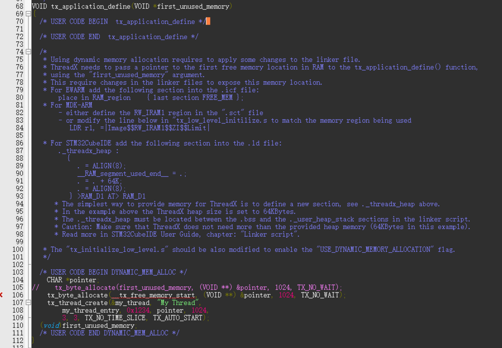

dynamic memory allocation

Hello @Szhen.1 ,
Take a look at this document: OSRTOS | Azure RTOS
This might help you.
