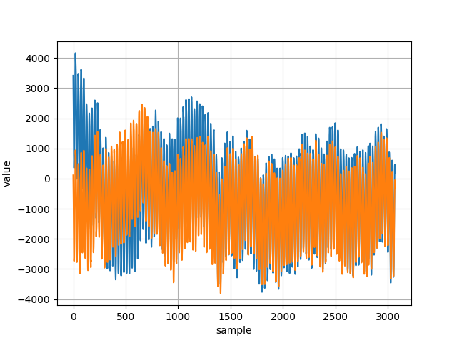

after some work with this application and some support from ST employees I managed to get some pretty good outcome, as you can se on Picture 1. On output I can see sinusoidal wave that I am giving on input of microphones, but I get a lot of offset and noise as well.0693W00000DmmobQAB.pngChanges that was applied:
  • changed speed of clocks (12 MHz -> 4.8 MHz audio clock, divider 4 -> 3, Oversampling 375 -> 200)
  • switched up L/R signal on two microphones
  • changed casting to int16_t because old one was causing wrapping
AudioBuffer[i*2] = (int16_t)(SaturaLH((LeftRecBuff[i] >> 8), -32768, 32767)); // changed from (uint16_t)
