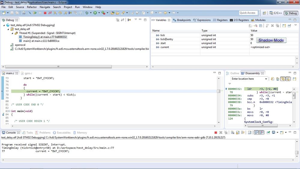

Posted on March 12, 2017 at 23:57
Why does my code not work?
STM32F103VET6
#include ''stm32f1xx_hal.h''
#include ''gpio.h''
/* USER CODE END Includes */
/* USER CODE BEGIN PV */
volatile unsigned int *DWT_CYCCNT = (volatile unsigned int *)0xE0001004; //address of the register
volatile unsigned int *DWT_CONTROL = (volatile unsigned int *)0xE0001000; //address of the register
volatile unsigned int *SCB_DEMCR = (volatile unsigned int *)0xE000EDFC; //address of the register
/* USER CODE END PV */
void Error_Handler(void);
/* USER CODE BEGIN PFP */
/* USER CODE END PFP */
/* USER CODE BEGIN 0 */
void EnableTiming(void)
*SCB_DEMCR = *SCB_DEMCR | 0x01000000;
*DWT_CYCCNT = 0; // reset the counter
*DWT_CONTROL = *DWT_CONTROL | 1 ; // enable the counter
void TimingDelay(unsigned int tick)
unsigned int start, current;
start = *DWT_CYCCNT;
do
current = *DWT_CYCCNT;
} while((current - start) < tick);
/* USER CODE END 0 */
int main(void)
/* USER CODE BEGIN 1 */
/* USER CODE END 1 */
/* MCU Configuration----------------------------------------------------------*/
HAL_Init();
SystemClock_Config();
MX_GPIO_Init();
/* USER CODE BEGIN 2 */
/* USER CODE END 2 */
/* Infinite loop */
/* USER CODE BEGIN WHILE */
while (1)
/* USER CODE END WHILE */
HAL_GPIO_WritePin(GPIOE, GPIO_PIN_5, GPIO_PIN_RESET);
TimingDelay(50);
HAL_GPIO_WritePin(GPIOE, GPIO_PIN_5, GPIO_PIN_SET);
TimingDelay(50);
/* USER CODE BEGIN 3 */
/* USER CODE END 3 */
/** System Clock Configuration
void SystemClock_Config(void)
RCC_OscInitTypeDef RCC_OscInitStruct;
RCC_ClkInitTypeDef RCC_ClkInitStruct;
RCC_OscInitStruct.OscillatorType = RCC_OSCILLATORTYPE_HSI;
RCC_OscInitStruct.HSICalibrationValue = 16;
RCC_OscInitStruct.PLL.PLLSource = RCC_PLLSOURCE_HSI_DIV2;
RCC_OscInitStruct.PLL.PLLMUL = RCC_PLL_MUL16;
Error_Handler();
RCC_ClkInitStruct.APB1CLKDivider = RCC_HCLK_DIV2;
RCC_ClkInitStruct.APB2CLKDivider = RCC_HCLK_DIV1;
if (HAL_RCC_ClockConfig(&RCC_ClkInitStruct, FLASH_LATENCY_2) != HAL_OK)
Error_Handler();
HAL_SYSTICK_Config(HAL_RCC_GetHCLKFreq()/1000);
HAL_SYSTICK_CLKSourceConfig(SYSTICK_CLKSOURCE_HCLK);
/* SysTick_IRQn interrupt configuration */
HAL_NVIC_SetPriority(SysTick_IRQn, 0, 0);
/* USER CODE BEGIN 4 */
/* USER CODE END 4 */
* @brief This function is executed in case of error occurrence.
* @param None
* @retval None
/* USER CODE BEGIN Error_Handler */
while(1)
/* USER CODE END Error_Handler */
#ifdef USE_FULL_ASSERT
* @brief Reports the name of the source file and the source line number
* where the assert_param error has occurred.
* @param file: pointer to the source file name
* @param line: assert_param error line source number
* @retval None
void assert_failed(uint8_t* file, uint32_t line)
/* USER CODE BEGIN 6 */
ex: printf(''Wrong parameters value: file %s on line %d\r\n'', file, line) */
/* USER CODE END 6 */
#endif
/************************ (C) COPYRIGHT STMicroelectronics *****END OF FILE****/2017-03-12 5:01 PM

2017-03-13 8:50 AM
You actually have to call
EnableTiming() for it to do it's job... otherwise the cycle counter isn't enabled.
