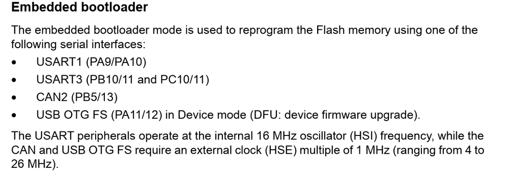

if you would look in the RM , you would see:
Is no CAN bootloader in STM32F103RBT6.
stm32F407 has:

‎2023-01-07 10:01 AM
no, i never boot on CAN , only USB .
maybe read here > CANFd. Reference was taken from "AN5405"
https://community.st.com/s/question/0D53W000022xmqCSAQ/stm32g0b1cbt6-system-bootloader-canfd-no-response
