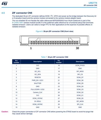

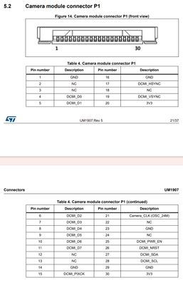

Hello again @Tajwar.Chandel
You can connect the board to the camera module using the  1 × 30 pin ZIF connector of each one of them.
For the camera module :
For the board :
for more details, refer to the UM1907 and the UM2779.
For the board :
Best Regards.
