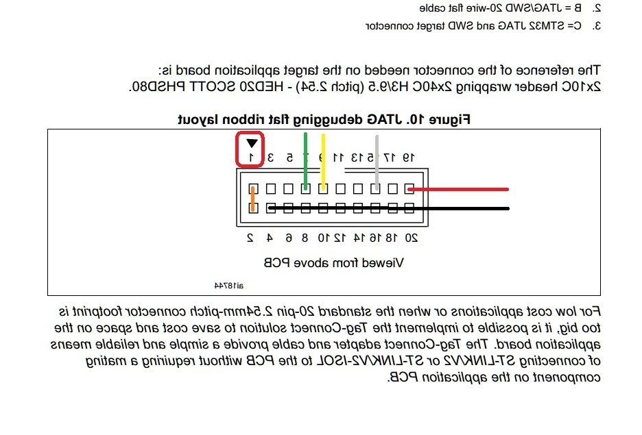

i connected st link to my stm32 on customboard ,
1 pin -> 3.3V, 7 pin -> SWDIO, 9 pin -> SWCLK, 15 pin-> NRST, 19 pin -> GND.
but keil doesn't recognize mcu.
I attach the image of the connection .
st link was damaged or wrong pin configuration?
thank you. i want to resolve this issue.
Thank you in advance

You don t need rst.
3.3v is adc monitoring input for stlink, not a supply to the target .micro.
Did you check pin1 of stm32 on your board? Which stm32?

Strikes me that you have the pin orientation completely backward.

Ok then perhaps you can enumerate your colour scheme, because the RED wire in the ribbon cable is PIN1, and the connector is a mirror image of the pins in the ST-LINK header it plugs into.​

Perhaps a diagram might help penetrate your cranium?
yes, thank you for your help . it seems it works now.
