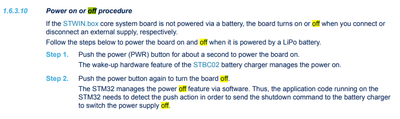

I have a STWIN.box , I would like to know how can I switch it off without unplugging the battery. It has a PWR button that works to switch it on but I can not find out how to switch it off.

Hello @iarakis
As mentioned on the UM2965:
Best Regards.
