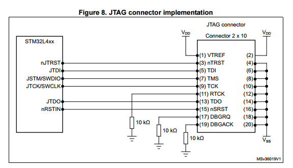

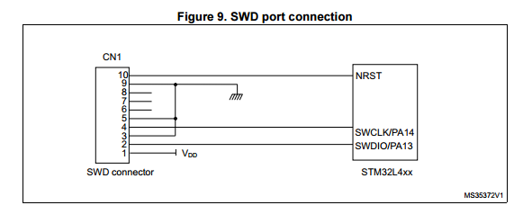

I have a problem with the ST-Link / V2. I have designed my own board and if I want to access the STM32L476RG via JTAG, the ST-Link Utility write the following lines into the Trace.txt file:
ST-Link/V2 device detected
Target voltage detected: 3.508662
Error (0x8) after target cmd F2 30 A4 00 00 00 00 00 00 00
Error (19) while initializing ST-Link in JTAG mode
If I use a Segger JLink Pro, I can flash and debug the MCU without any problems.
Can anyone explain this?

Posted on January 16, 2017 at 12:35
Hi
Heil.R
Please verify yourJTAG & SWDconnector implementation referring toPinout and debug port pins section on the
http://www.st.com/content/ccc/resource/technical/document/application_note/group0/93/81/9b/8d/2f/09/4a/e8/DM00125306/files/DM00125pdf/jcr:content/translations/en.DM00125pdf
-Nesrine-
