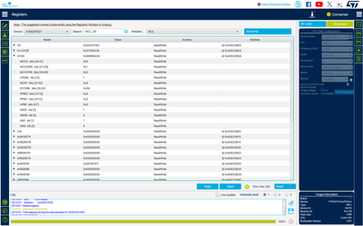

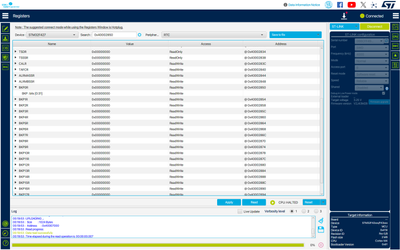

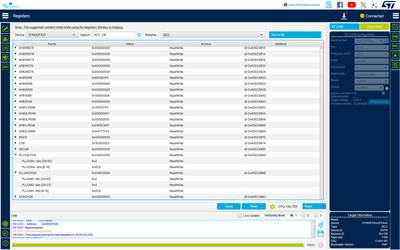

hey, I did try pulling nRST low, didn't work.
according to stm cube, its stuck somewhere in bootloader.
also I found BKP0R = 0x00000000
I am newbie with stm32 , I was just trying to clone ardupilot FMUv4 (pixracer) the schematic is also referenced from pixracer with only difference being I used 10k pull up on nRST while pixracer uses a voltage supervisor (mcp131).
I haven't modified the firmware, I am using ardupilot pixracer firmware on it (it works on off the shelf Flight controller) so I guess the firmware and boot loader is fine.
