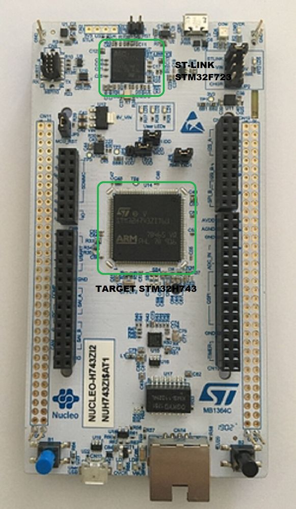

+ what is target cpu ? v3+mb1440 is just programmmer+adapter .
You don't program the IC on the ST-LINK/V3SET, it is an intermediary connection with an STM32 Target on your own board
PC -> ST-LINK -> TARGET STM32
If you want a board with the debugger, and a target chip, look at the NUCLEO or DISCO boards.
