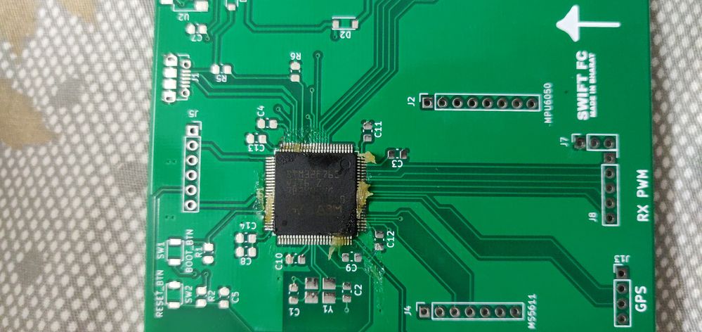

I have custom board with minimal design only stm32 chip is there and couple necessary capacitors and due to some soldering issue, i got shorted with 3.3 and gnd .. accidentaly i powered it on and for debuging it was connected like this for 2 minutes. now stm32 is not communicating through swd. Did it brick stm32 by shorting 3.3 and gnd for a minute ?

oh ok so my dot has to be straight instead of the text right ? can you please correct me if i am wrong since i only have one chip left and then i will have to order it and in my country it will come after a month
Now is it correct ? the dot is now in upper corner
Put a bit more effort into your question.
Can you please elaborate ? I have updated the image with newer pcb and solder paste is attached just ready to solder after i have a confirmation that orientation is correct. Waiting for your confirmation
Thank you sir!!!​
This orientation is now correct.

In any case, orientation is now correct based on the position of the crystal.
Hello Thank you sir for the help now it is working......
