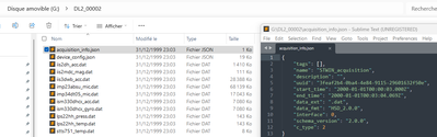

Result:
When opening the SD card (G:), I only see one folder, DL2_00001, which contains non-empty .dat files.
In G:/DL2_00001/acquisition_info.json, the start_time and end_time show a duration of about 3 minutes, as expected (see below).

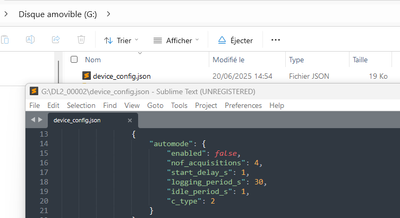

There’s also a new config file at G:/DL2_00001/device_config.json (see below), and interestingly, it shows "enabled": false instead of true, but all other parameters (nof_acquisition, ..) are the same than G:/device_config.json. That’s why I suspect the logger is reading the config file located at the root (G:/device_config.json), but for some reasons not using the automode as expected.

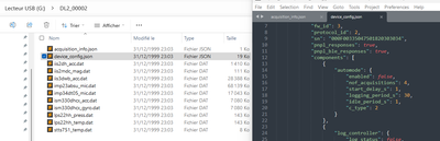

I also tried another experiment:
After repeating steps 1 to 5, I waited until the green LED turned permanently ON (which, to me, indicates a crash ). This time, I got a G:/DL2_00001 folder, but all the .dat files were empty (iis2dh_acc.dat, stts751_temp.dat, etc.), and the folder was missing both device_config.json and acquisition_info.json.
