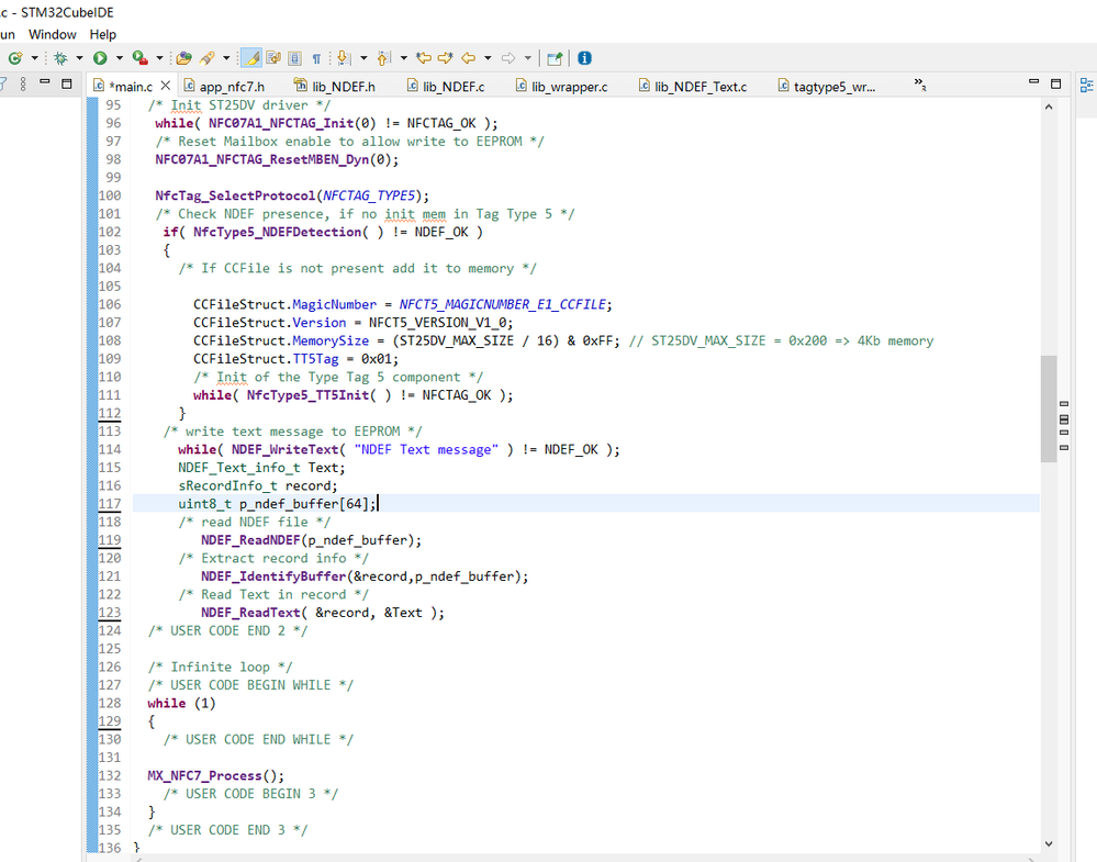

I used the I2C example in X-CUBE-NFC7 to write "hello the world" and wanted to read the data from the phone, but according to the above code the phone does not show any NDEF information, what should I do?

NFC07A1_NFCTAG_WriteData writes raw data into the tag. So, the memory of your tag is basically containing "Hello the world" at offset 0 which is not an NDEF formatted data. If you want to write NDEF formatted data, make sure to use the lib_NDEF API. See en.x-cube-nfc7\Projects\NUCLEO-L476RG\Applications\NDEF_URI: this example application shows how to write an NDEF message to the ST25DV64KC EEPROM using the NDEF lib middleware.

I've seen ndef. lib file, but I did not see the function of this code in the main function of STM32CUBE IDE, and the phone could not read any messages after downloading the program. Is there any relevant example that can be written into NDEF? Hi, I read the message from ndef. lib file, but I did not see the function of this code in the main function of STM32CUBE IDE, and the phone could not read any messages after downloading the program. Is there any relevant example that can be included in the information of NDEF?
The following is the code I designed. Why can't NFC Tag APP read any NDEF information
