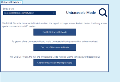

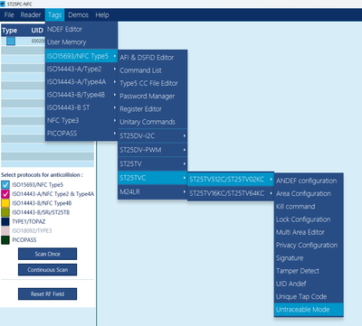

Note: the untraceable mode can be exercised with the ST25PC-NFC. Start the ST25R200 Eval Gui and click on the ST25PC-NFC icon:
Once running the ST25PC-NFC, go to the Untraceable mode menu.
Then, you can toggle the untraceable mode and check its behavior.

Hi Tanuj,
make sure to check the Response_flags of the ToggleUntraceable response. It is likely that Error_flag equals 1 due to  something wrong in the ToggleUntraceable request. Make sure to follow section 5.1.3 Password encryption when building the unique valid Password_data value in the ToggleUntraceable command.
