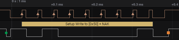

ST25R3917 doesn't commnicate on the I2C (Address 0x50) it seems like the chip doesn't start. Maybe a problem with the crystal?
- Drawn current is 50uA
- Signal on MCU_CLK is a 32.5kHz Squarewave
- IRQ line stays low
I assume that the capacitance on the 27.12MHz crystal might be a problem (10p) an has to be lowered. Before changing the capacitance I would like to ask if there might be another reason for the problem.
As far as I understand one should get a high signal on the IRQ line once the chip started correctly. What should be the frequency on the MCU_CLK pin after a cold start and how much current should the device draw if its unconfigured?

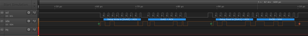

register access to the ST25R3917 is possible without (running) oscillator/external crystal.
When software enables the oscillator (en bit) and the I_osc interrupt is not masked the IRQ line will be driven high once the oscillator is deemed stable. Such does not happen automatically.
The 32kHz on MCU_CLK indicates that the internal low power oscillator got enabled.
I would start looking at the I2C protocol - most common is a shift of the address - whether direction bit is included or not.
As reference you will find here a read from ST25R3916 (with address 50h, shown here as 0xA0) from register 02h. I recommend starting with read from register 3Fh (IC identity), where you will need to send 7Fh instead of the shown 42h.
0693W00000LxK32QAF.pngBR, Ulysses

BTW: It seems like Saleae changed the I2C address interpretation in the new version:

I tested the third board with I2C_EN connected to VDD_D instead of 3V3. Unfortunately with the same result. As the waveform used for communication seems correct, we might have a PCB assembly problem. Does the BSS line need to be tight to GND when operating in I2C mode? I couldn't find any information on that.
Is 2.01V a normal reading on the VDD_D (when VDD, VDD_TX, VDD_IO @ 3.3V)?

TWirt.2061
Hello Ulysses,
thank you for the good instructions. I solved the problem with the scope. The SDA signal dropped a couple of hundred mV during the ACK phase. Its a bit embarrassing but the GPIO configuration was the problem. I assumed that the alternative function mode will take care of the output configuration in HW and disables the normal IO stages. As this isn't the case it was set to default (push-pull) so the master kept the SDA line high. Simple problem, simple fix but not easy to find on a friday afternoon ;) Thanks again.
