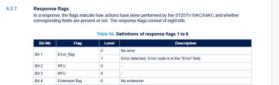

The received length from the api was 5 and the data is 0x00, 0x02, 0x1D, 0x00, 0x02. The response flag is 0x02 which means error detected as per the datasheet, and the error code makes no sense
I think you would need to go one level deeper and observe the bytes received from FIFO of the  reader chip.
Does this buffer "gRFAL.TxRx.ctx.rxBuf" give enough information ?
