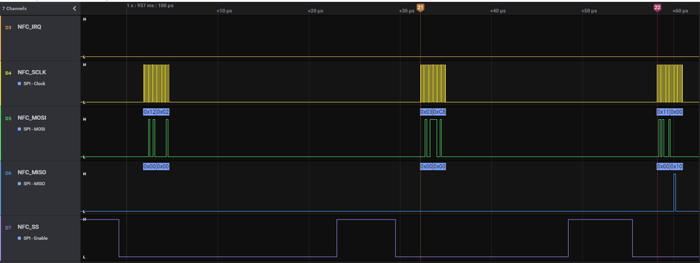

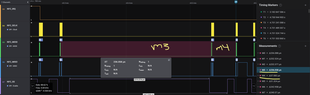

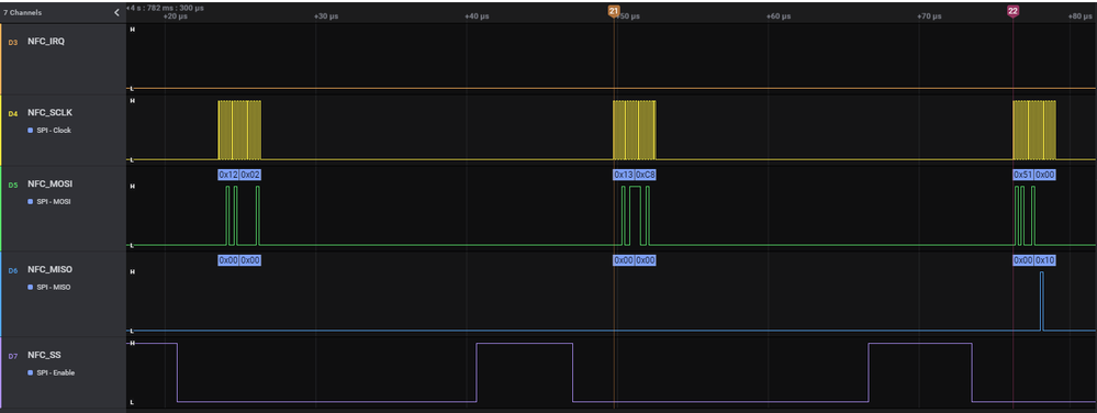

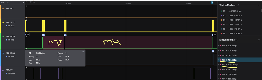

    I had one of our HW folks run an analyzer on those lines. I have the analyzer capture files - they are for Saleae Logic 2, which has a free Linux tool to view the captures: https://www.saleae.com/downloads/
    Anyway, her summary of the logs are as follows:
    -timing does meet the listed spec in the datasheet (at least from what the logic analyzer measured - could do another measurement on the scope to get another point of data to confirm if needed). However with the gcc9.4 build takes about 225microseconds before it gets to the next register where as the gcc7.5 build it's only 20microseconds (these areas are marked with the pink measurement field)
    -sometimes the addresses aren't incremented as expected with gcc9.4, at least compared to the gcc7.5
    If you need copies of the logs let me know and I'll find someplace for you to download them - they are about 93MB each and there are two logs: one for the gcc7.5 and and for gcc9.4.

    Addresses aren't incremented: See below

    Addresses aren't incremented: I'm not exactly sure what was meant by this, but maybe the following pics will help. The first two show how a short/long timing interval swapped between gcc7.5 and gcc9.4.
    0693W00000DlngMQAR.png0693W00000DlngCQAR.pngThe next two show a change in increments:
    0693W00000DlnhAQAR.png0693W00000DlngvQAB.pngI sent you a private message with links to download the analyzer .sal files.

    the Logic Analyzer files have be analyzed and it appears that the content of the user transmit buffer is incorrect. Thus, as the transmitted command is invalid, the tag does not reply and an ERR_TIMEOUT error is returned to the user application.
    I would suggest to check the content of the txBuf is not modified/corrupted until the completion of the transceive command.
