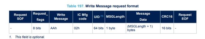

I would like to report 2 possible bugs on the rfalST25xVPollerWriteMessage implementation:
  1. The msgLen parameter must be "number of Data bytes minus 1", as a direct translation from the "Write message" command, but msgLen == 0 is not accepted as valid (rfal_st25xv.c line 205), failing to write 1 byte-long messages, which according to the ST25DV datasheet should be OK.
  2. The required TX buffer len (calculated on line 202, and checked on line 205), considers 2 bytes for the msgLen parameter, but this parameter is only 1 byte long, preventing from using buffers that are the exact (and correct) number of bytes long.

which version of RFAL do you use (see #define RFAL_VERSION  in rfal_rf.h)?
Issue #1 has been corrected and the fix is provided in latest RFAL versions. The updated code in line 205 is the following:
/* Check for valid parameters */
    if( (txBuf == NULL) || (msgData == NULL) || (txBufLen < msgIt) )
        return ERR_PARAM;
Regarding the second issue you reported, here is the format of the Write Message:
 0693W00000DmPtJQAV.jpgThus, the size of the buffer is the sum of:
  • sizeof(flags): 1 byte
  • sizeof(cmd): 1 byte
  • sizeof(ICMfgCode): 1 byte
  • [sizeof(UID: 8 bytes] optional
  • sizeof(MSGLen): 1 byte
  • MSGLen + 1
Therefore , if I am not wrong, line 202 is correct:
/* Calculate required Tx buf length:                    Mfg Code               UID                      MSGLen  MSGLen+1 */
    msgIt = (uint16_t)( msgLen + sizeof(flags) + sizeof(cmd) + 1U  + ((uid != NULL) ? RFAL_NFCV_UID_LEN : 0U) + 1U + 1U  );
Note: the MSGLen parameter has been clarified in the comments:
/* Note:  MSGlength parameter of the command is the number of Data bytes minus - 1 (00 for 1 byte of data, FFh for 256 bytes of data) */
One additional information, the ST25 Embedded NFC library provides a ST25 fast transfer mode embedded library. See Application Note AN5512 and related ST25NFC_Embedded_Lib_ST25R3916\Projects\STM32L476RG-Nucleo\Applications\X-NUCLEO-NFC06A1\FTM demo.
Rgds
BT

#2 You are right, the last +1 is the correct offset for msgLen when considering its value is "number of Data bytes minus 1", my bad!
