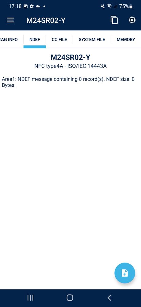

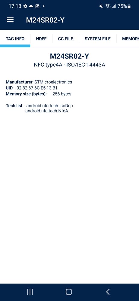

After writing a NDEF message to the M24SR02-Y NFC Tag the Chip doesn't work anymore. If I scan it with a NFC app I can see that under technologies NDEF isn't listed anymore. Before the writing process it was listed. Does anybody know a reason for this?
Brian TIDAL
you probably try to write a bluetooth record with mine type = application/vnd.bluetooth.ep.oob but your buffer seems corrupted with a 00 every 2 bytes (it looks like a Double Byte Char String issue). So the NDEF message inside the tag memory is inconsistent. Using the  ST25 NFC Tap, you can go to the MEMORY tab and see that the content of the NDEF is incorrect.

Brian TIDAL
can you use the ST25 NFC Tap app and provide the information returned by the app after the NDEF Write? Also, make sure to have the I2C token being released before starting an RF session (see M24SR02-Y datasheet §4.2).

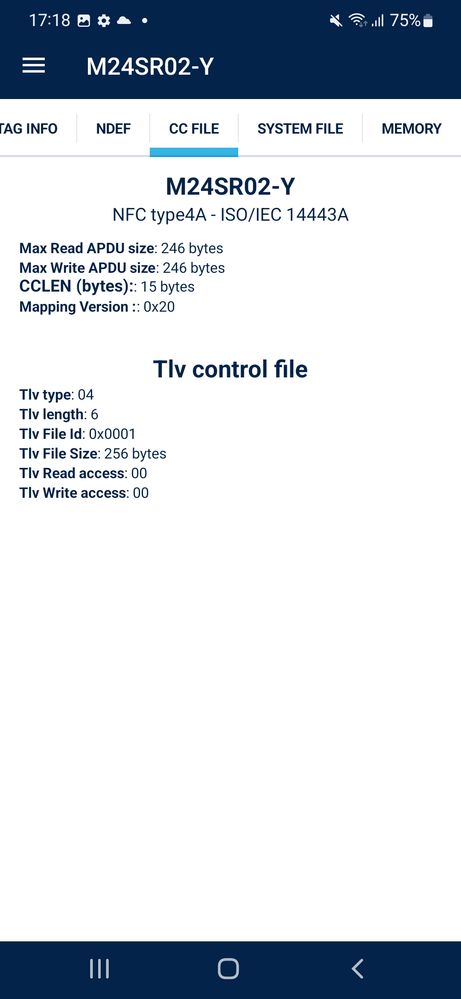

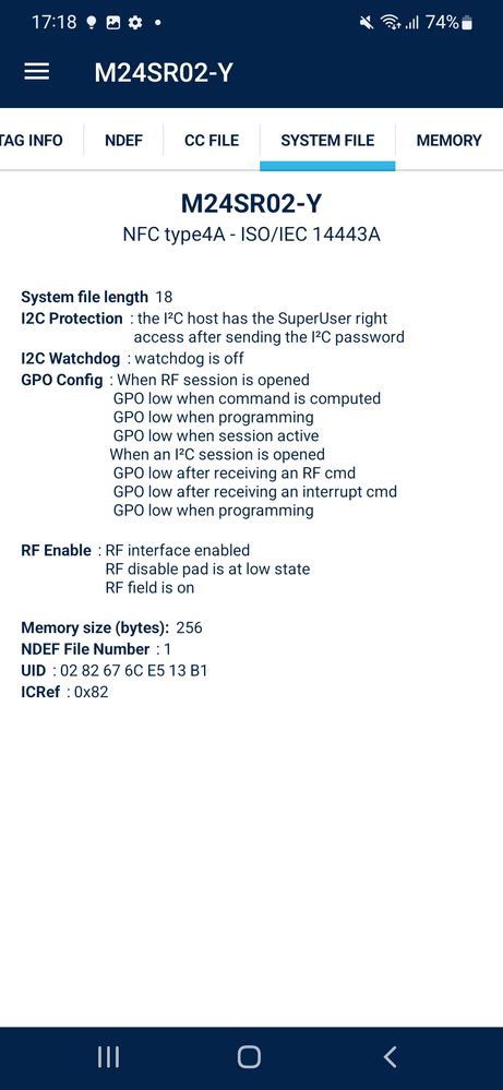

hhest.1
0693W00000SvNMpQAN.jpg0693W00000SvNN4QAN.jpg0693W00000SvNNOQA3.jpg0693W00000SvNNTQA3.jpgThis are the informations the app gets from the tag. To close the I2C session I just turn off the supply voltage of the tag.
The NDEF file seems to be empty, but during communication via I2C I get "command completed as response. Here is the whole writing process:

Brian TIDAL
Rgds
BT
hhest.1
Oh I see. I fixed the bug in my code and it is working now. Thank you very much for your help.
