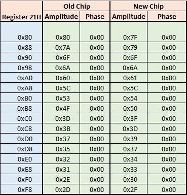

SD.5
Hi Ulysses,
On the reference code, There is a comment says that the Antenna calibrate command needs to be run twice( Errata #1.5). (Screenshot attached)
Can you share the errata 1.5 with us?
Please find the Amplitude and Phase values for both the chips.
Thanks
Sarav
Hi Sarav,
can you double check your phase measurements it is always 0x00 (>=150deg)? Which function did you use? From RFAL?
With such a phase for all trim values the Calibrate Antenna should always have produced an error (also in the old ST25R3911) as the target phase could not be achieved.
I will need to discuss internally, it would be helpful if you could use VNA to produce smith charts of at least trim values 0, 7 and 15 and share them here or with me.
Regards, Ulysses
