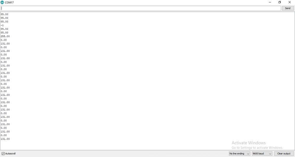

The Serial Monitor:

Brian TIDAL
​Hi,
would you please share more details about your HW setup:
  • do you use a X-NUCLEO_NFC03A1 expansion board connected to your Arduino? or a PLUG-CR95HF-B? or a custom board?
  • do you use wrapping between the CR95HF board and the Arduino board?
  • what are the values of SSI_0 and SSI_1?
  • feel free to add a picture of your HW setup?
I am not sure to understand why you are using float to read the CR95HF UART output.
From what I can see in your serial monitor trace:
  • you send echo command (0x55) and you get 85 answer (i.e. 0x55 ==> echo answer) from the CR95HF
  • you repeat this 2 times then line 32 there is a strange  serial.println(BTserial.read(). I guess this is a mistake.
  • then repeat this 2 times the sending of echo command and receive the proper echo answer (85 = 0x55)
  • having the proper echo answer proves that the UART interface is operational
  • then you sent 02020201h to select protocol ISO14443 but the last parameter (01h) is invalid (bits 3:0 are RFU)  so this command is failing
  • then you try to send a REQA using SendRecv command  which return 131 (0x83 = Invalid protocol) as the ProtocolSelect has failed.
So from what I see, the UART is working properly. You have to fix the ProtocolSelect command (e.g 02020200h) and fix the reception of command response:
  • read the response code byte
  • read the length byte
  • compute the actual length according to the datasheet (see  § 4.3 support of long frame)
  • read the N bytes of data
Note: you don't need to repeat the sending of echo command when you receive a correct answer. As soon as you get 0x55 answer, you can exit the initialization phase and go to the main job.
Rgds
BT

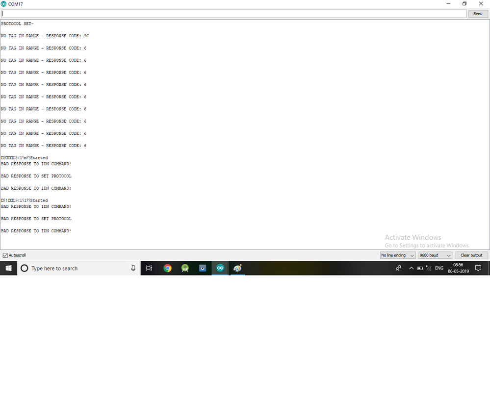

Did all the changes you suggested, still the problem exists. This code was written for an Arduino UNO and it works absolutely well with it as we have tested it with an UNO as well. But with Nodemcu this problem follows. Kindly help me out with the full code to solve this problem as we've already bought 50 CR9fHF chips and we have to make it work with a Nodemcu.

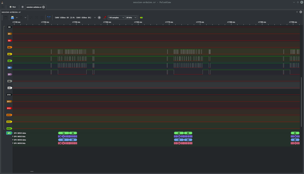

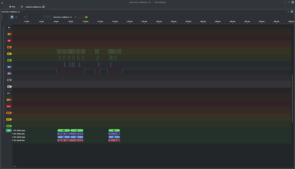

Brian TIDAL
​Hi,
I would suggest to create a new thread as this one was initially related to an UART communication issue. Please make sure to describe your HW setup (i.e. ESP8266 MCU connected to BM019 module over SPI), the serial communication setup and your SW setup.
Regarding your question about the SPI clock frequency, the max value is defined in the CR95HF Datasheet: 2.0 MHz. Make sure to check the various SPI parameters as defined in §6.4 SPI characteristics of the Datasheet.
I had a look to the screen shots: I believe the logic analyzer is not properly configured as the MOSI and MISO values do not make any sense. Make sure to trace SCK, MISO, MISO, SPI_SS, IRQ_IN, IRQ_OUT and to provide the logic analyzer channel configuration (i.e. what is D4, what is D5, etc.). If possible, attach the logic analyzer log file rather than screen shots. Which logic analyzer do you use?
The typical startup sequence is to send a echo command, receive the echo answer and then send an IDN command:
MOSI       00 55           02 XX          00 01 00             02 XX XX XX XX XX XX XX XX XX XX XX XX ...
MISO       XX XX           XX 55          XX XX XX             XX 00 0F 4E 46 43 20 46 53 32 4A 41 53 ...
IRQ_OUT    -------------______------------------------------_________________________________________ ...
           ECHO                           IDN
                           ECHO RSP                            IDN RSP
Rgds
BT
