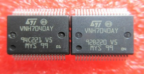

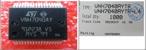

Can i get the trace code from below marking information on the device?
Not exactly, but you should be able to cross-check the lable​. Assembled on different lines, a week apart.

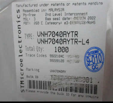

This is the label information, but some of the code been removed. So not sure if the marking on the device is comply with the label trace code or not.
Does the trace code on the marking is match with trace code on the label ?
Can you please help to check

If someone offers devices with labels where the Bulk ID and/or parts of the trace code(s) have been made unrecognisable, a lot of scepticism is always (!) appropriate because the person has something to hide. Either they are counterfeits or illegal resales.
The trace code alone is not sufficient for a well-founded statement.
