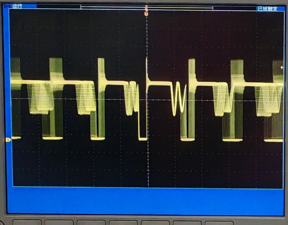

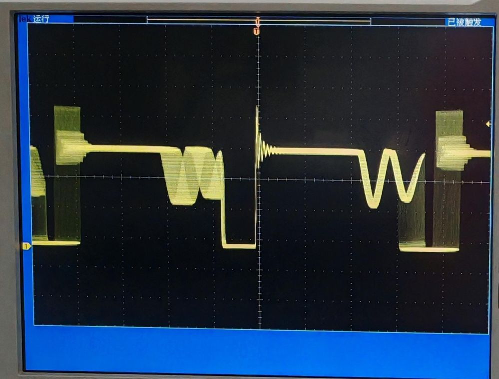

The frequency and duty cycle of the VDS waveform of VIPER267K are constantly jittering.
Eejoo
When measuring my VIPER267K flyback power supply, I noticed that the frequency and duty cycle of its VDS waveform kept jittering. Is this normal? What could be causing this? VDS2.jpgVDS1.jpg
AScha.3
Take a look at the ds :
So check: is it in the range of the built-in jitter ? Then its working as it should.
