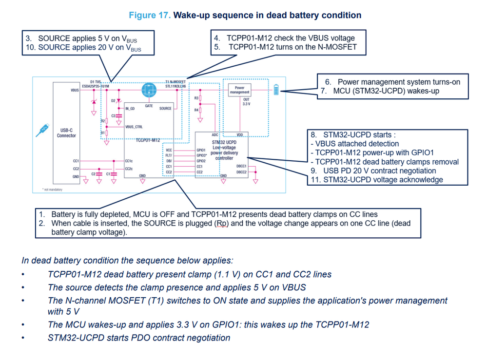

I have a technical question regarding the Dead Battery startup sequence. When the system is first connected to a charger and is completely unpowered:
​VCC of the TCPP01-M12 is strictly 0V because the LDO hasn't started yet (the MOSFET is still open).
​DB pin is also at 0V.

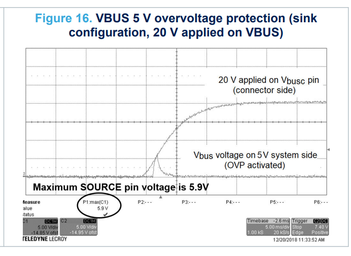

​Internal Powering: How does the TCPP01-M12 energize its internal OVP comparator and Charge Pump to drive the GATE pin when its own VCC pin is at 0V? Does the chip draw parasitic power from the VBUS_CTRL pin or the VBUS line to enable this initial logic?
​OVP Safety: How can we guarantee that the OVP logic is fully functional and capable of blocking the Gate Driver BEFORE the MOSFET closes, especially if a non-compliant 20V source is connected to this unpowered system?
​Charge Pump Mechanism: Could you clarify if the internal charge pump for the IN_GD (22nF bootstrap) is self-powered from the VBUS input during this "cold-start" phase?

    In dead‑battery mode the TCPP01‑M12 powers its essential protection and gate‑driver logic directly from the VBUS side. It does not need VCC or DB to be present for basic operation.
  2. OVP safety
    As soon as VBUS is present, the OVP comparator (supplied from VBUS) is already active. If VBUS is above the OVP threshold (e.g. 20V non‑compliant), the gate driver is blocked and the external MOSFET remains off, so the system stays isolated.
  3. Charge pump during cold‑start
    The internal charge pump and the IN_GD capacitor are also supplied from the VBUS‑derived rail. They only start driving the GATE when VBUS is within the allowed range; if OVP is triggered, the charge pump is inhibited and GATE is kept low.
For a sink‑only, 5V/3A application using TCPP01‑M12 with MCU powered from a 3.3 V LDO downstream of the MOSFET, the safety concept is:
  • Protection path and OVP logic are powered from VBUS, not from VCC, at plug‑in.
  • MOSFET is kept off by default. It is only turned on after:
    • VBUS has been verified to be within the safe voltage range by the internal OVP comparator, and
    • the internal charge pump, powered from VBUS, drives GATE
  • If an out‑of‑spec 20 V source is applied, OVP detects it first and prevents gate turn‑on, protecting the downstream 3.3 V rail and MCU even with VCC = 0 V.
Does it answer your questions?

start sequence is in ds ...:
OVP also shown:

​Hi,
​Thanks for pointing that out! Those timing diagrams from the datasheet really help to visualize the sequence, especially seeing how the OVP is ready to block the Gate even before the system starts up.
