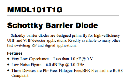

I am working on a project involving input signal in the 3-5 GHz range. For the rectifier circuit, I wanted to use the BAS70-04FILM diode by ST. Is that suitable for the given frequency range though? Else is there any alternative for the same?

you can try it - any Schottky diode will work in some way... a 70V diode is more for power supply etc.
but you should take a real RF-diode, if you want more, than just "works a bit" .
This is a rf diode:
https://www.mouser.de/ProductDetail/Advanced-Semiconductor-Inc/5082-2835?qs=EU6FO9ffTweWz7nfvMI64w%3D%3D
or many others, like :
https://www.mouser.de/ProductDetail/onsemi/MMDL101T1G?qs=P4IOph%252Bbot9kQ4drEZyhAg%3D%3D
here a real fast one, expensive also:
https://www.mouser.de/ProductDetail/MACOM/MSS39-152-H20?qs=%252B6g0mu59x7Ked%252By5qPRwHw%3D%3D
But to get to 5GHz - is not easy.
What it should do ?  Check RF level? Small signal, big - how many mV ?
