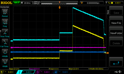

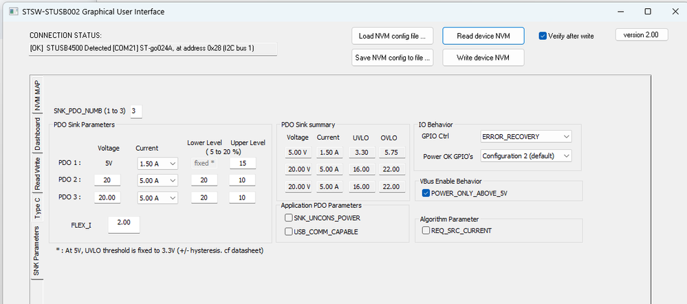

I am using the STUSB4500 to power a device with a large inrush current. I have configured the PDO's for 20V @5A which should be more than sufficient to meet the power requirements.  I have selected POWER_ONLY_ABOVE_5V so that it will not attempt to power the device at 5V (which would draw 4 times as much current). See my settings below:
However, when I connect a 100W USB-C PD adapter to the circuit I see the chip first negotiate 5V before switching to 20V. I think that is expected but what I did not expect is the VBUS_EN_SNK to pass through the 5V. I believe this is causing the overcurrent protection to trip on the USB adapter (after a short delay) so we see the power turn off shortly after the switch to 20V. In the below scope trace the yellow is VBUS and the cyan trace is VSink (see  schematic attached).
Has anyone run into this issue?  Any idea what I might be doing wrong?

I assume that for your tests, there is nothing connected on Vsink. Indeed, this phenomenon can be seen when Vsink is floating : by connecting a load, this state should be highly reduced.
Concerning the 20V output, I am not sure it is due to the Sink. Indeed, we can see that Vsink rises normally to 20V, which means that negotiation between the Source and the Sink is successful.
Above 3A, only smart cables can be used. Do you use a smart cable which support 5A and which is able to answer to the Source requests ?
Do you have a way to look at the communication messages between the Source and the Sink using a USB spy like STM32G071B-DISCO ? It seems that VBUS collapse is decided by the Source, as VBUS also decreases slowly (and at the end, this is maybe the STUSB4500 which triggers the detachment when Vbus < 16V).
Note that instead of programming PDO2 and PDO3 with the same values, it is safer to set the number of PDOs to 2.

It turned out that my FET was blown so it was passing VBUS to VSink regardless of what the VBUS_EN_SNK level was.
